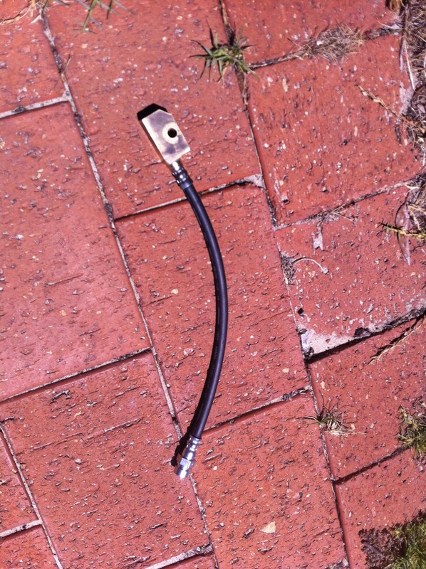

Well yesterday was quite eventful! Went to Repco after I got out of bed and bought some oil, an oil filter, coolant, timing belt kit, and a harmonic balancer puller. I figured I use works often enough, it'd be easier if I had my own. At $30, it wasnt too bad. All up that came to $250, which is annoying, but very much worth it. Time to get into it!!
The brake line I had made up by ENZED in Ozzy Park cost $65. If anyone needs hoses or fittings, I recommend these guys. Absolutely fantastic work, they're yet to let me down! The hose was fitted in about 5 minutes, with the mounting bolt conveniently found in the glove box.
This was the new hose:
Shiny!!
Fitted:
Not too hard.

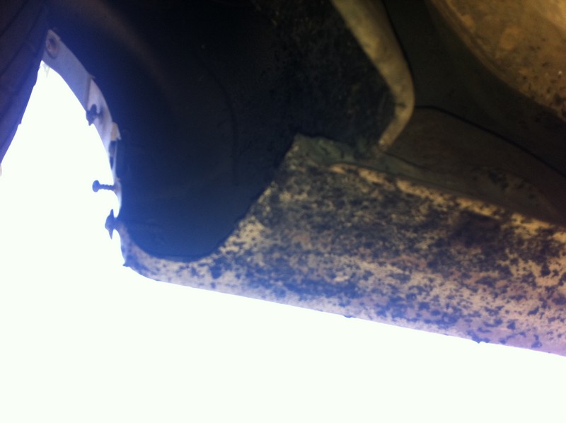

This is the result of the previous owner's abuse:
Piss weak! Hahahahaha

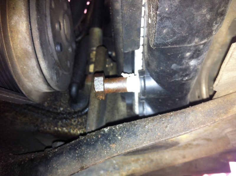

Jumping under the car to drain the coolant so I can remove the radiator and found this:
Interesting way to block up the radiator drain! Lol. Had fun trying to chase all the coolant with the drain bowl too :confused:

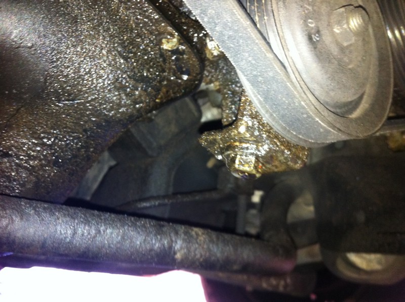

You can see the oil leaks here too:
Yummy! Gotta give that a clean when I get it to work.

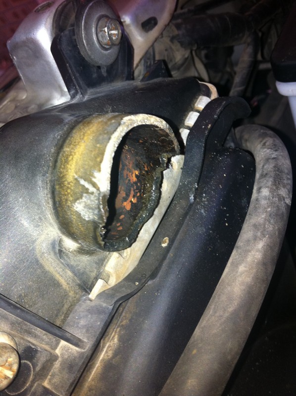

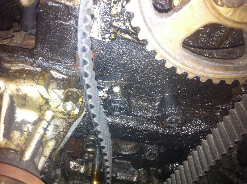

Back to the engine bay, the top hose of the radiator came off surprisingly easy! Then I realised why:
She very broken! Posted a few WTB threads around, then went back to work.

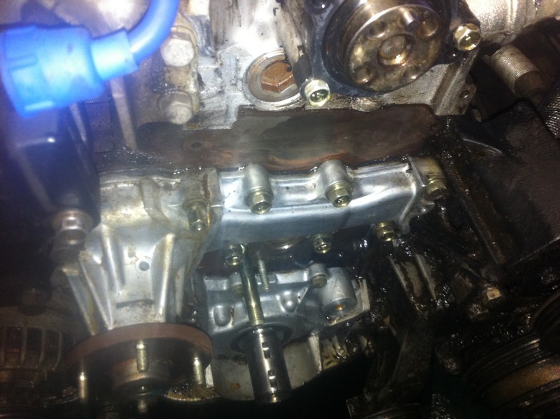

Looked familar! Ive dont timing belts on RB25s and RB26s before, so this was pretty easy compared to those.
The thing was filthy under there though:
That shit was a few mm thick in some places! 2 cans of carby cleaner and 2 cans of degreaser later, and this is what I had:
MUCH better!! Obviously its not perfect, and as you can see everything outside the timing cover is still caked with crap, but that would have taken me much longer to clean and I didnt have enough degreaser, so I'll wait until I can take it to work then I'll get the high pressure sprayer in there and go crazy. Should get it all nice and spotless.

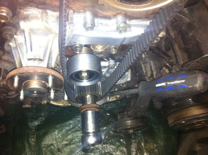

According to the workshop manual (which I dont actually have a copy of), the cam is set up to add pressure on the timing belt in order to keep it tensioned. To counter act this, you have to remove the rocker cover and loosen off the cam bolts... FUCK THAT!! I just wound the crank a tooth back, fitted it up so the lines on the timing belt matched up with the notches on the cam and crank cogs, then while holding the belt on the crank, moved it back so it lined up perfect. As I was working alone, I needed something to hold the belt in place while I stood up and fitted it on the tensioner (I was laying on the floor at the time). I remember reading on another forum about a "wedge" to hold the timing chain in place on a KGC10 Skyline, so I came up with the PEFECT solution:
Kingchrome spanner wedged in between the block and the belt, then wedged into the power steering pump! Worked perfecty!!

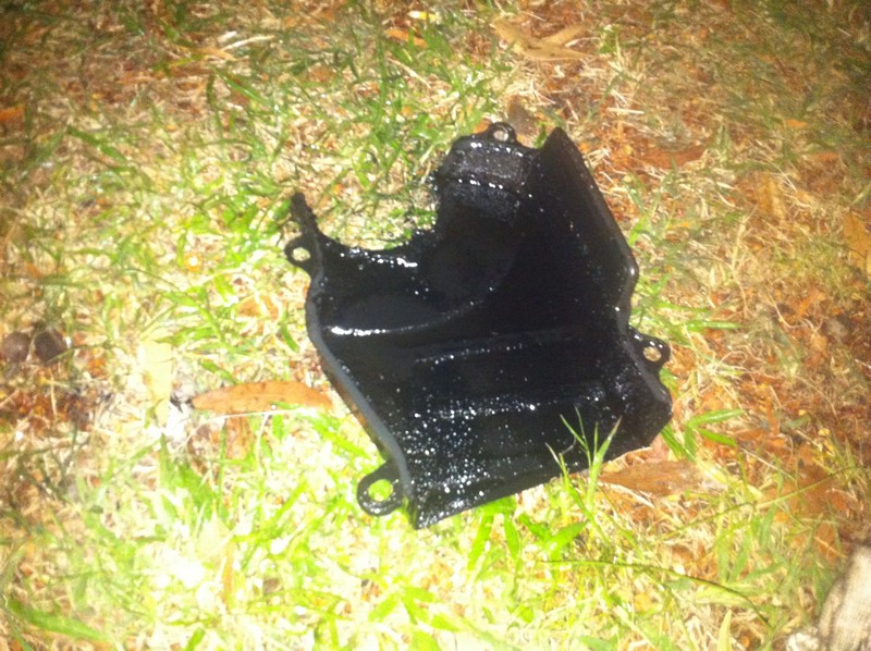

Gave the timing cover a good clean before refitting it:
Also very dirty! Gave the outside a quick clean, but wasnt too thorough cos it was going to be cleaned with the high pressure sprayer anyway.

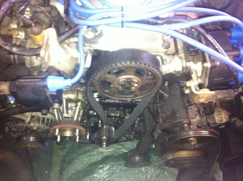

So it all went back together, and this is how it sat for the night:
All complete but radiatorless. Drove it back onto the lawn and let it sit there for the night. Time to go catch up with Nic and Emma for a wel earned beer!! Lol
