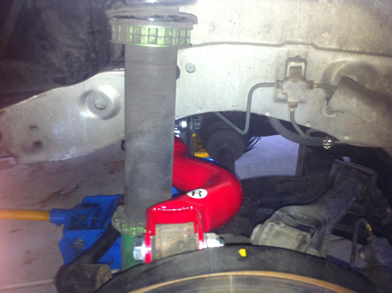

These are the camber arms:
Installed:
Cant wait to get the guards lipped and a wheel alignment!

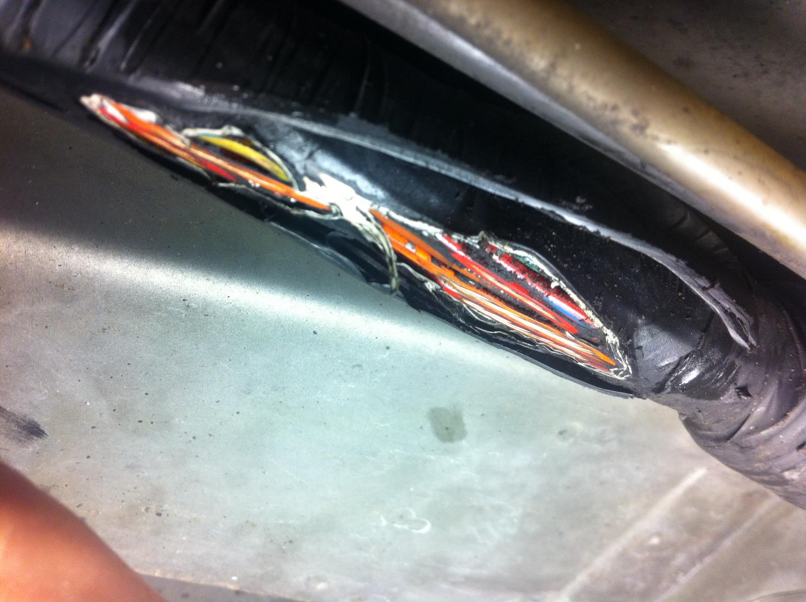

Ok, found this while it was on the hoist getting a service:
The joys of owning a stupidly low car!! A week later, and she looked like this:
Close up of the standard loom location:
Not too much room to move!
First thing I did was actually fix the window washer hoses. I ran over some metal one night (I was only doing 20km/h thank God!!) but it cut the clip holding the hoses up and they fell onto the tire, which obviously wore a hole into them before I caught it. Some 6mm irrigation piping I found in the shed and a couple of adaptors and they were good as new:
Nothing too interesting, but worth noting anyway.
I taped up the damaged section of the loom, then took out 2 of the 3 clips. The middle clip I took off and put it back on the other way, then pulled the loom up and over the ledge its attatched too. To avoid the ledge rubbing through the loom (and basically undoing what I'm trying to achieve here) I cut a 400mm long piece of irrigation hosing (this shit is really usefull! And free from Dad's shed ), then cut a slit down the middle so it sat over the ledge and provided a soft surface.
Unfortunately I didnt take any photos of the finished product, but you can see the hosing here:
All in all, there is now plenty of room for the tire to move before it hits the loom. Job well done I think!
